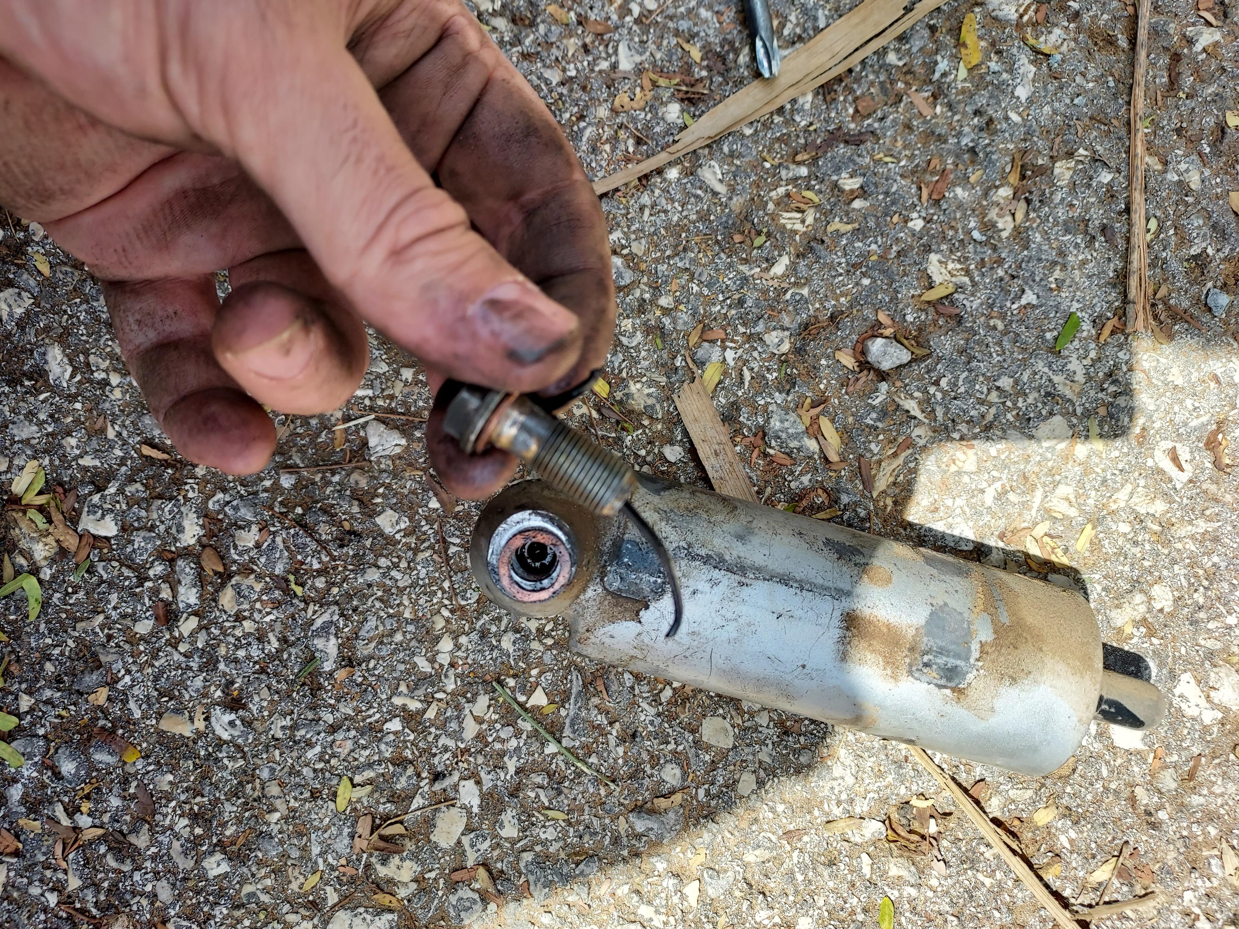

Did you remove the banjo bolt on the compression adjuster side? I have a broken rubber there and I don't know how it was or how to replace it.

Thanks. Can you upload your pictures? Also did you take the bolt i show in the picture and can confirm there shouldn't be a rubber like that anywhere on this side?

Direktly on the mount of the rubber hose isn't a rubber seal. Just two out of copper.

What about inside the hole the banjo fitting? Between the 2 washers?
Xplorer
Beiträge: 162
Wohnort: Minden
Re: Federbein hinten
Beitrag von Xplorer »
Nope. There shouldn't be a Rubber seal. Just the copper washers, the Banjo fitting and the screw.
To avoid any leakage, try to use New copper washers.
