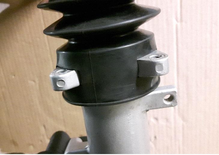

I got mine from ebay. They were for Harley Sportster. Enduro fork boots are much longer typically and I did not like that look.
Fit to fork:

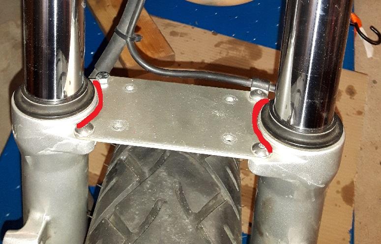

You may need to grind the ends of this fork brace / front mudguard bracket so that the rubber fits between fork and the connector plate.

Melitos hat geschrieben: 14. Okt 2022, 19:48I got mine from ebay. They were for Harley Sportster.
So were mine! :D
Melitos hat geschrieben: 14. Okt 2022, 19:48Fit to fork:
Love the idea! I never thought about doing it this way... I was basically thinking about doing a cut-out around the entire brace and not just the parts where it's screwed onto the fork... this might be something to do over the winter (in case we get one).

@Melitos
Thank You! That is a clever solution!
