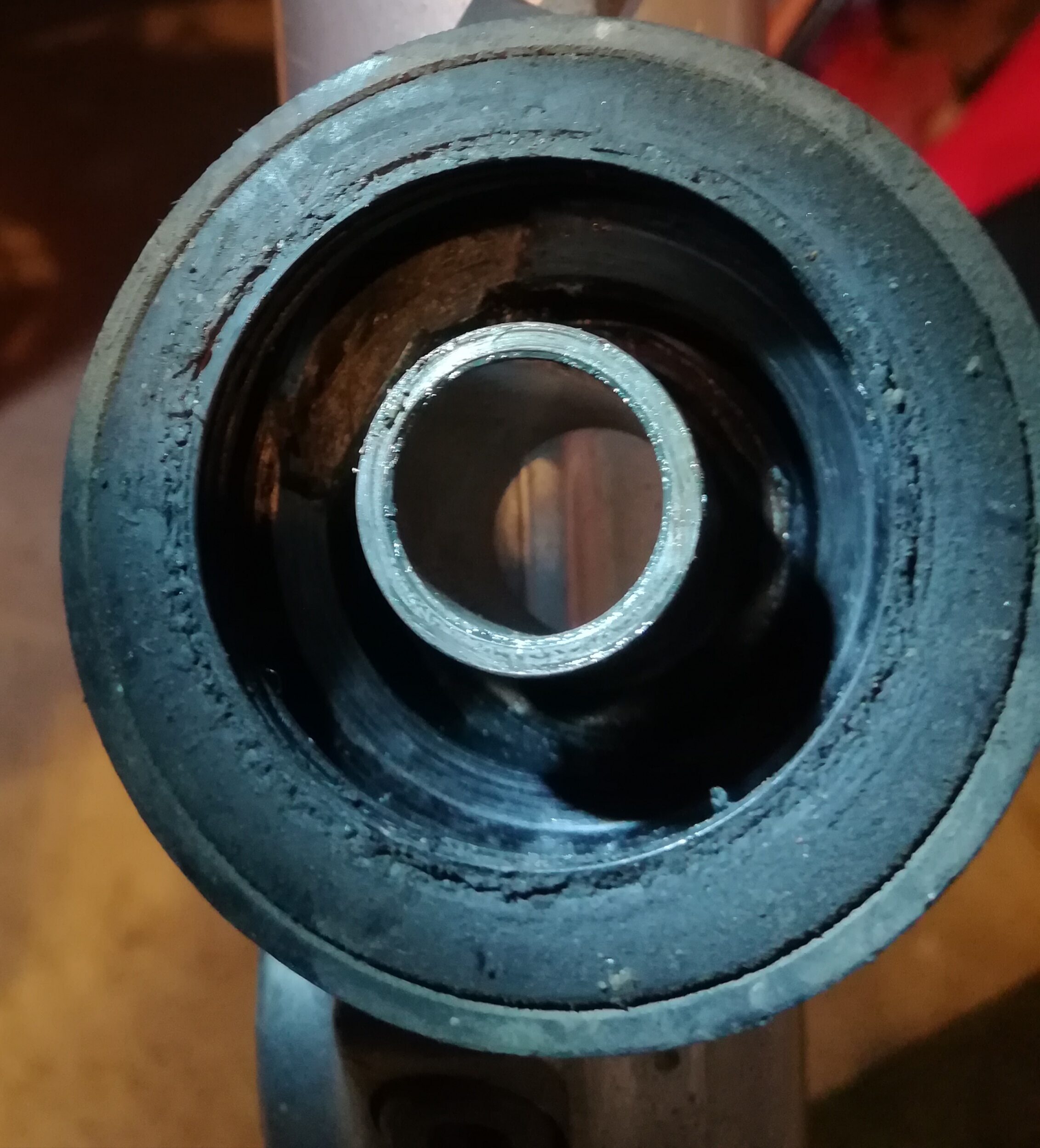

Your guess was spot on. The wings on the rotor is totally worn out.
My question now is, the housing seems damaged too. Look at the picture. Will a new rotor work in this housing or is a whole new piece needed?
Re: Horn signal and speedo (tacho) kaputt
It doesn't look so bad. Take a look after cleaning it.
the sealing ring can be removed easily.
I don't think that the small plastic-parts from the broken rotor-wings can cause a damage of the housing.

- Speedometer problem was the "tacho rotor" (magneto / speedo rotor). New part from Swedish dealer solved the problem, although the housing was a bit damaged. Since the part is not lying directly to the material in the housing (instead hold by magnet), it´s not necessary to have a perfect surface in the latter.
