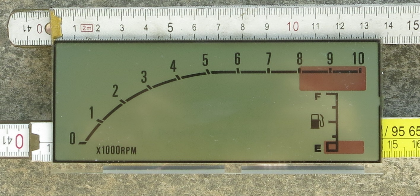

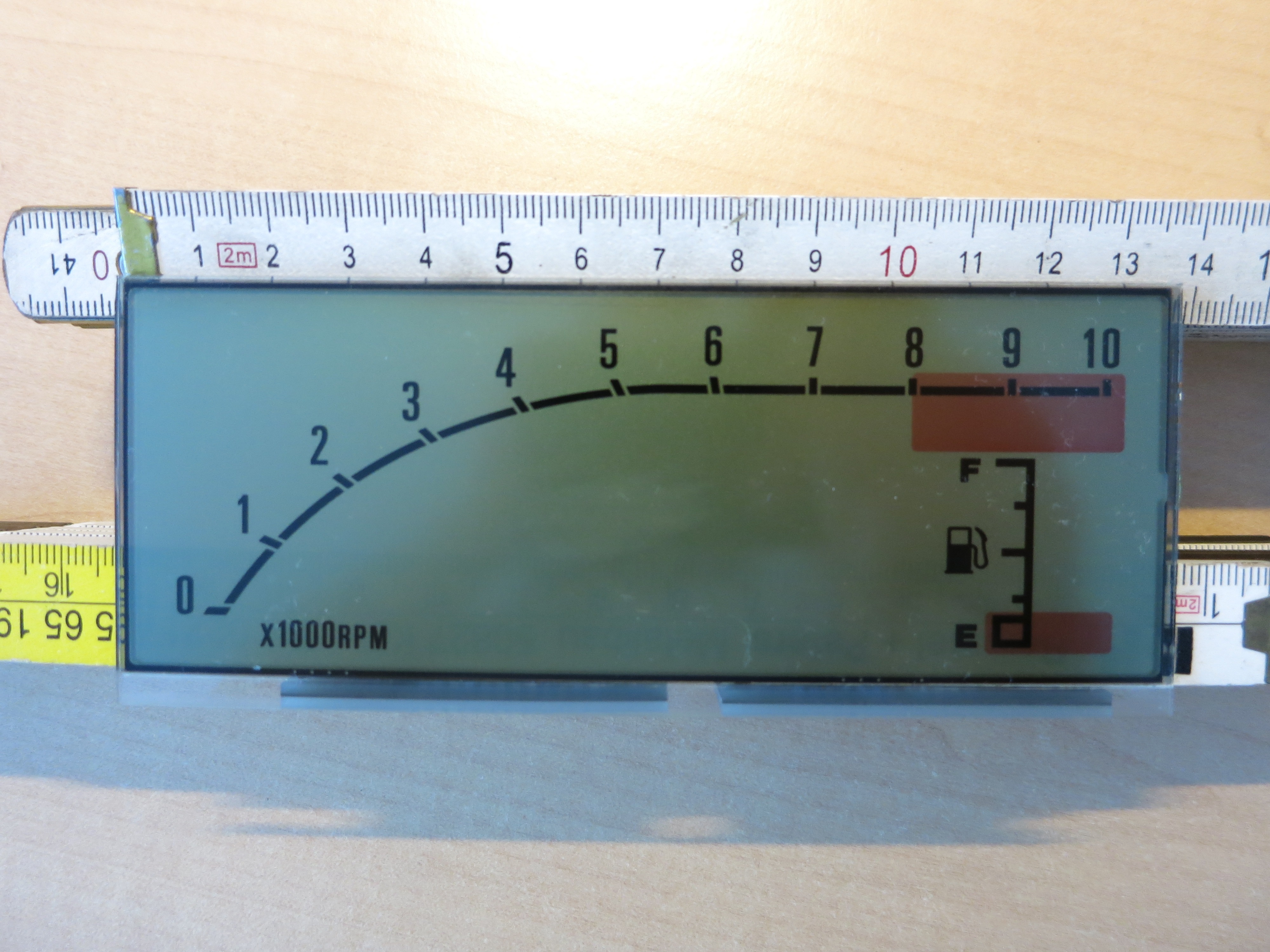

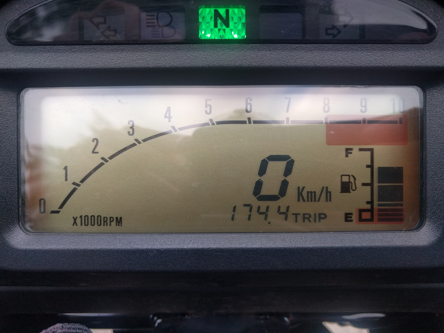

I just took the LCD from a spare speedo and tried to get a decent photo. But I don't have the right camera equipment. Either I have too much distortion when the camera is close or the image is rather blurry. I can get a flatbed scanner from the basement, I think you'd be able to make factory grade prints from that. But I'd have to find the scanner first.
Anyhow, here are two images I made:
http://www.xf650.de/forum3/images/archi ... _close.jpg
http://www.xf650.de/forum3/images/archi ... do_far.jpg

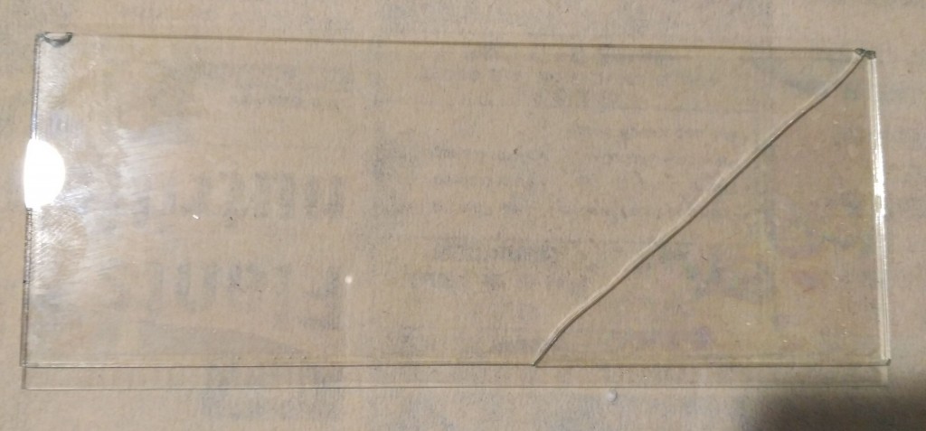

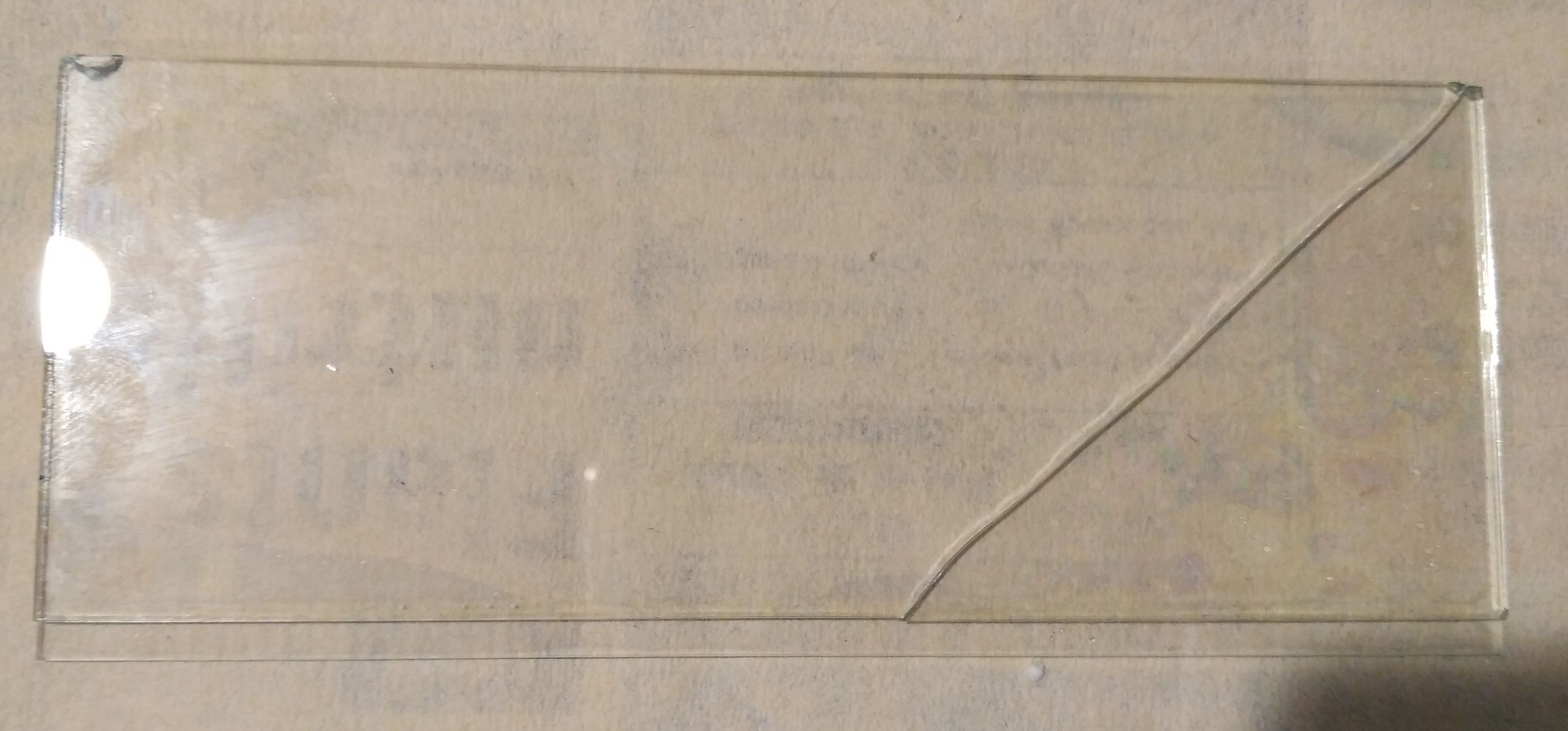

Thank you so much for your help. Your pictures are great, & I'm sure I would have been able to do something with them, but I've had a stupid accident with my LCD panel. I was giving it a final clean, before scanning it to get an image that was in scale , & I went & dropped it on the floor & broke it. I was going to try to adjust one of your pictures to match the size of the scanned image, but I've blown the whole idea now. I feel so stupid, & I'm really sorry to have put you to any trouble.
I guess I will have to try & find a second hand one now. It had become a bit of a challenge to rescue mine, but I'll never know now, if it would have been successful.

It has just happened to me today, I dropped the glass screen and it broke. Does anyone here want to sell only the lcd screen ? or a whole speedo?
