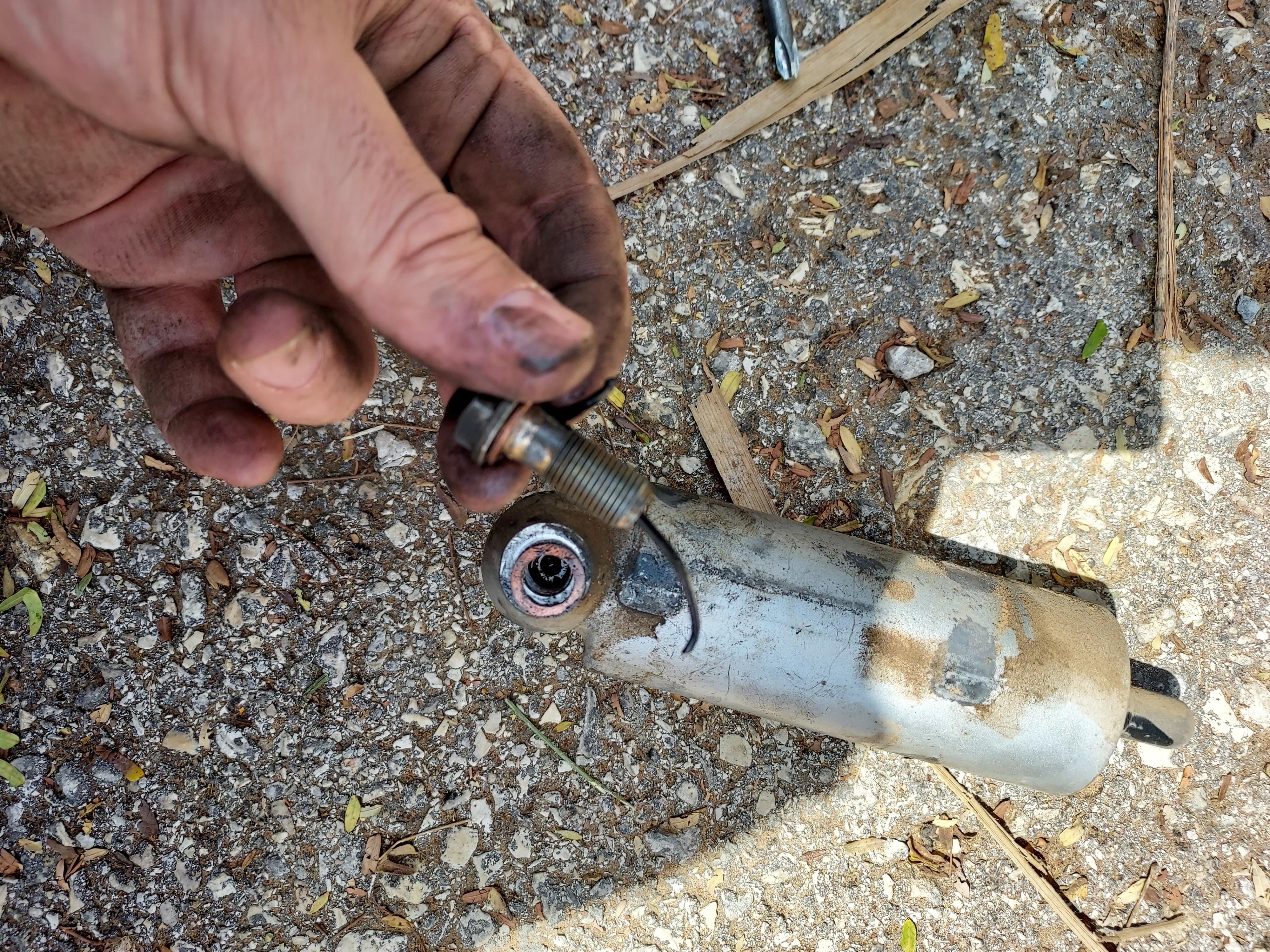

Anyone knows how this rubber was supposed to be in the compression banjo bolt of the rear shock absorber and if it's possible to install a new rubber or bolt?
Xplorer
Beiträge: 156
Wohnort: Minden
Re: stoßdämpfer
Beitrag von Xplorer »
In my eyes there shouldn't be a Rubber Part?! Just the screw, the two copper rings and the tube.
Where did you find the rubber? :D
Konfuzius
ronenfe
Beiträge: 79
Wohnort: Israel
Re: stoßdämpfer
Beitrag von ronenfe »
Exactly where you see it. Inside the banjo bolt and goes outside the hole and wrapped like an o ring around the banjo fitting groove between both gaskets. Maybe the technician that rebuilt the shock put it there for some reason? I don't remember seeing this when I took it apart and before giving it to him. Anyway I ordered a complete used shock so I will be able to answer this in the future.
